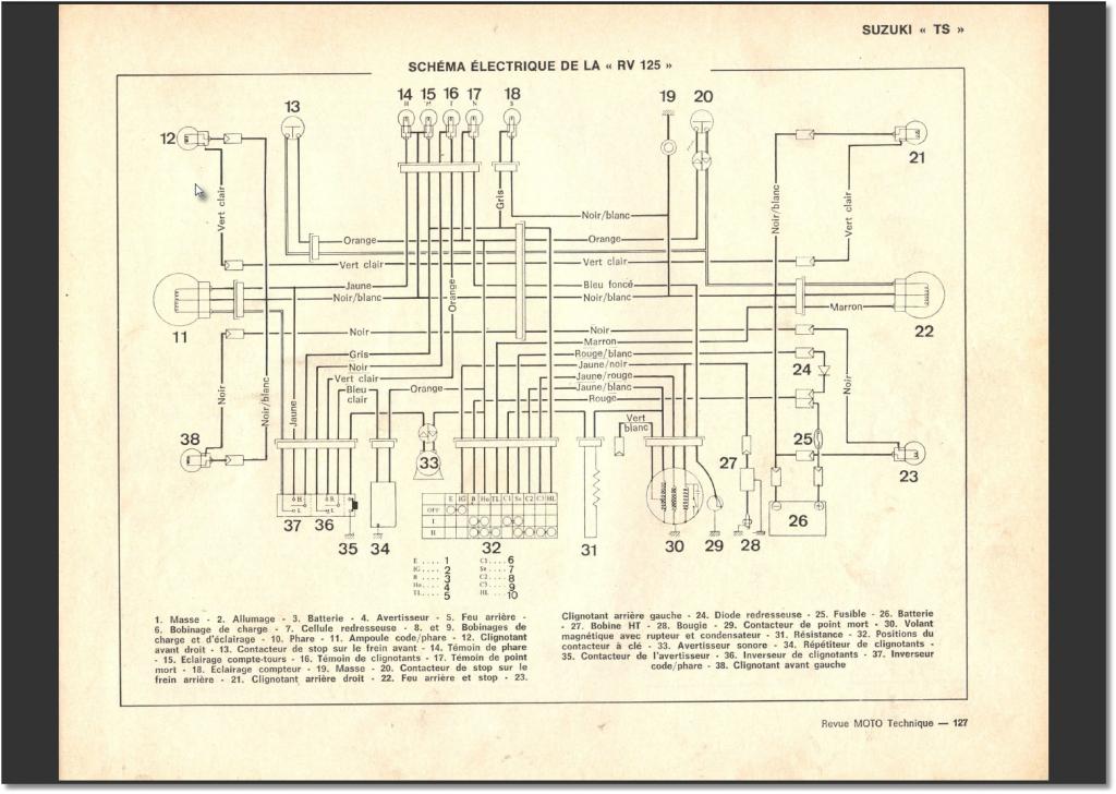

PostPosted: Sat 7 May - 17:21 (2011) Post subject: Probleme de jus Reply with quote
Petit cadeau en retour ...
